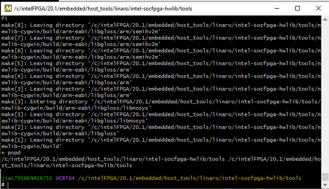

    I tried the first three steps as per the MYSYS part. I attempted to do the ./install_linaro.sh. I got the following response.

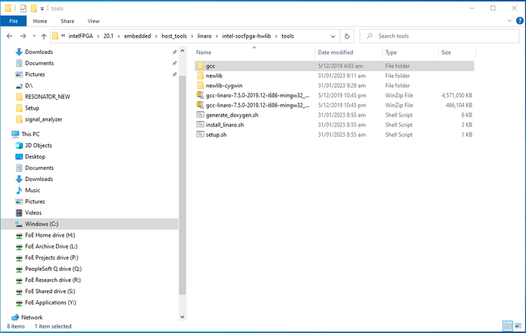

    I am not sure whether this is right or wrong. But it took a long time to get this one. I checked the files and there is new file called intel-socfpga-hwlib which comprises of the following

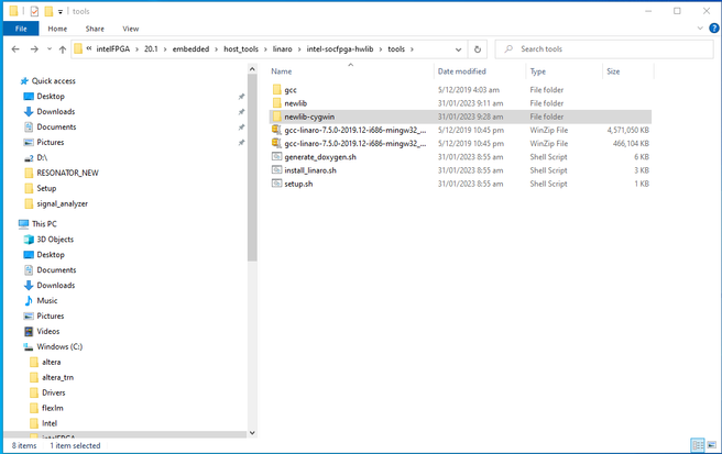

    On clicking on tools, I got the following,
    What I can see is is now there is a new file called "newlib" and "newlib-cygwin". As per the instructions given, it says that the installation of linaro will setup Linaro toolchain, newlib and cygwin in your system.

  • tehjingy_Altera's avatar
    tehjingy_Altera
    Hi Jacob
    The folder structure looks about right. The linaro have been compiled successfully.
    You could double check your PATH environmental variable. the gcc path will be part of it. If it is not there you could manually add it in using the command : " export PATH=`pwd`/gcc/bin:$PATH"

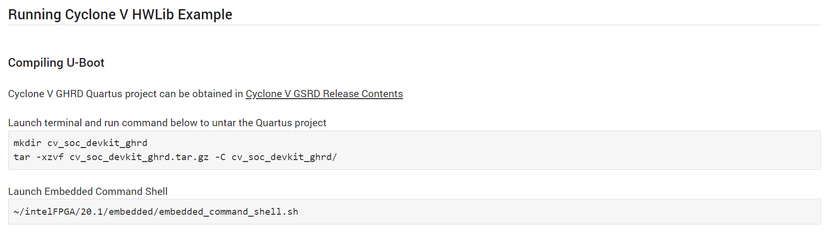

    I was attempting to do this link https://www.rocketboards.org/foswiki/Documentation/HWLib?elq_cid=7076518_ts1675282356531&erpm_id=102... in Quartus 20.1 Prime Standard Edition.
    I was able to successfully compile Linaro on MSYS. However, when I attempt to run the Uboot, I am a bit puzzled when they say run the terminal and do these.
    I checked this link too https://www.rocketboards.org/foswiki/Documentation/CycloneVSoCGSRD#Release_Contents and I attempted to write the SD card too and my PUTTY shows something like this
    tehjingy_Altera
    Hi Jacob
    The wording at the rocketboard are not correct.
    You do not need to open a terminal to your board. The command there should be entered into the MSYS terminal.
    Jingyang, Teh
