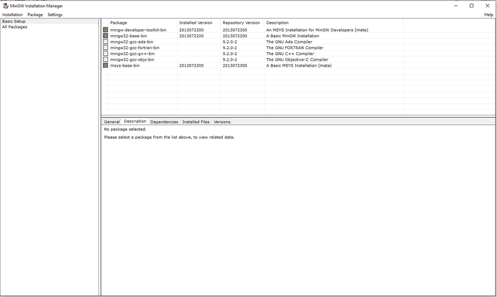

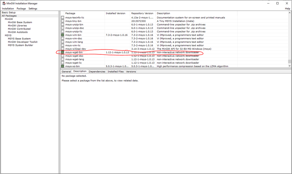

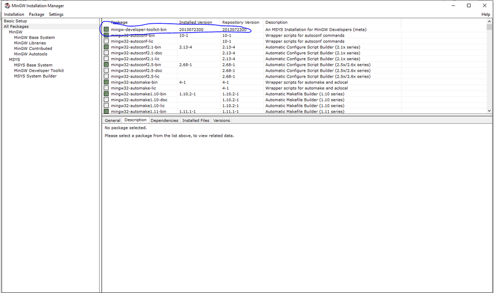

Did you install the following packages in MinGW? (mingw-developer-toolkit-bin mingw32-base-bin msys-base-bin msys-wget-bin)
Did you also run the MinGW in administrator mode?
Jingyang, Teh
- jjac705
I have checked all of them in administrator mode. All of them are installed according to the figures attached.

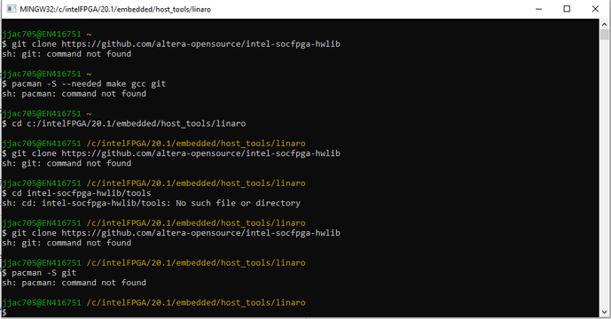

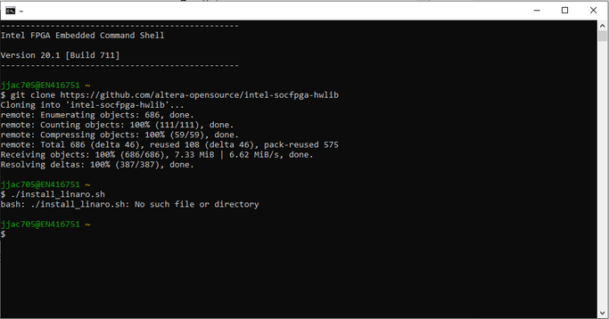

Hi JingyangTeh,
I am pretty new to this concept and I cannot understand git repo or anything for that matter. I attempted to use "git clone https://github.com/altera-opensource/intel-socfpga-hwlib" in MinGW and it says
However, when I attempted to do the same on SoCEDS 20.1, I got the following response,
These are what I am getting as of now.

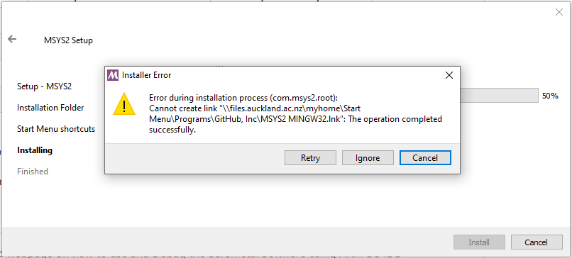

- jjac705
Moreover, I cannot install MYSYS properly too as per the github link.
