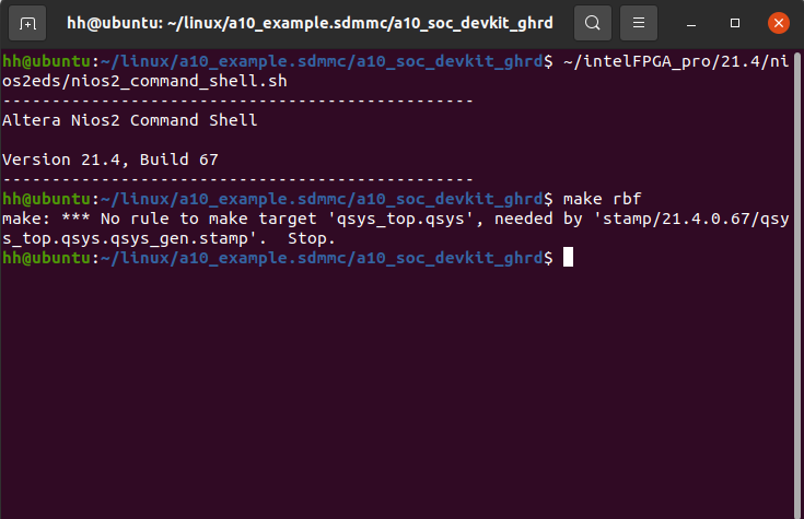

Now I have a new problem, when I type make rbf, it returns an error.
- EBERLAZARE_I_Intel
Did you run "make generate_from_tcl" first?
