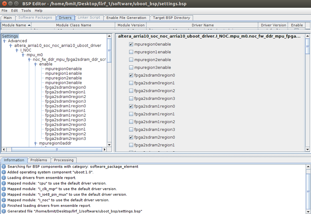

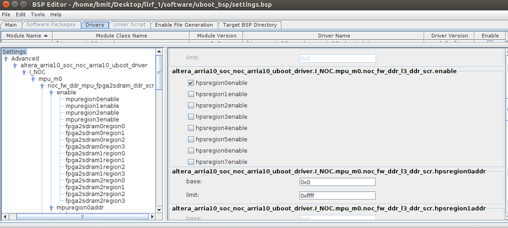

For generating uboot image I am using bsp-editor, but unable to understand the changes which we need to apply in uboot drivers in bsp editor. The attachment contains the bsp-editor image in which modification is required.

  • Hi,
    After generating the new handoff folder, you will need to compile a new preloader and uboot image based on the new handoff folder generated.
    I would recommend try to compile and run with the new preloader and uboot image to see if this improve the issue.
