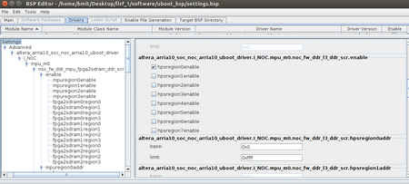

Hello, I am building Linux OS for our custom board which took reference from Arria 10 . I have designed the uboot_mkpimage.bin file and uploaded it in SD Card by taking reference from below link...

After generating the new handoff folder, you will need to compile a new preloader and uboot image based on the new handoff folder generated.
I would recommend try to compile and run with the new preloader and uboot image to see if this improve the issue.
