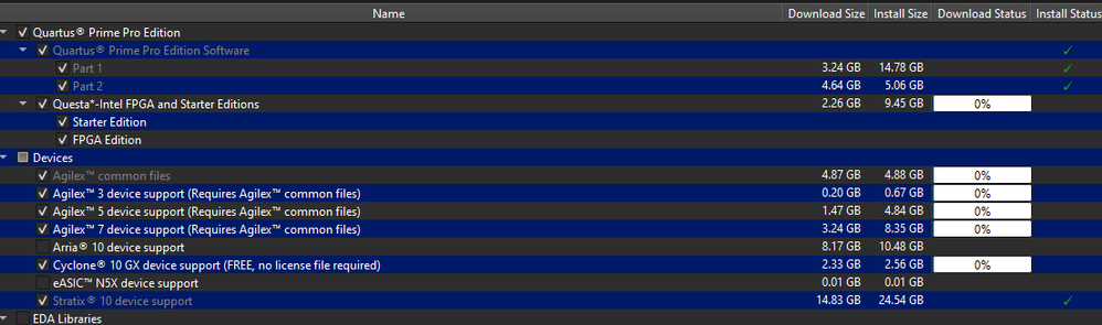

    You can check the installed devices through the GUI mode, but not much can be done using the CLI mode.
    1. In the screenshot I provided earlier, you can see that the Stratix 10 device is installed, and the Install Status shows a green tick.
    2. Alternatively, as mentioned by sstrell, you can simply open a project in Quartus and check whether Agilex 5 is available when selecting Devices.
