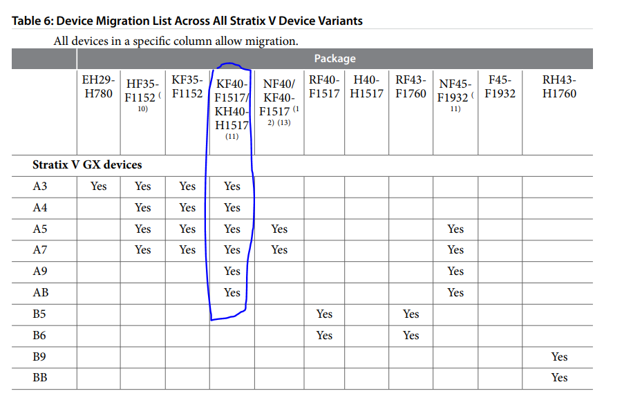

You can check Table 6 from this document : https://www.intel.com/content/dam/www/programmable/us/en/pdfs/literature/hb/stratix-v/stx5_51001.pdf
You can apply device migration from the same package across logic counts (vertical -refer pic below)
or can use Quartus software to select migratable device for your Quartus project.
