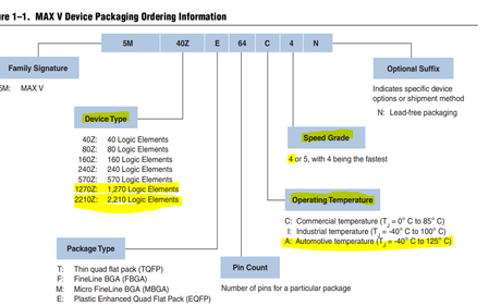

We are short this component. I think the highlighted parameters are drop-in with out changing the firmware but I need confirmation. Do we need to recompile if the size of the device is changed and a...

4 years agoHi Mangala,
It is NOT required to recompile the programming file in following cases:
1) The two devices have same package and pin count and the design pins are allocated such that they have same functionality, meaning an IO should not be a power or GND pin.
2) While changing between devices with different temperature grade and/or speed grade. However, for moving from faster to slower speed grades, it is good to check the timing of the design before migrating.
