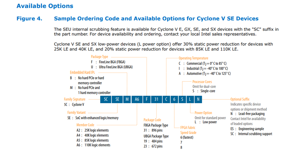

Dear Support,
Good day,
Please advise difference between part numbers 5CSEMA5U23I7N & 5CSEMA5U23I7NCZ?
What is the suffix "CZ" as this is not explained sample ordering code?
Can they be both used interchangeably? Please confirm. Thanks
