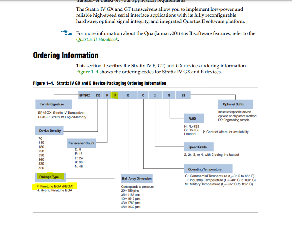

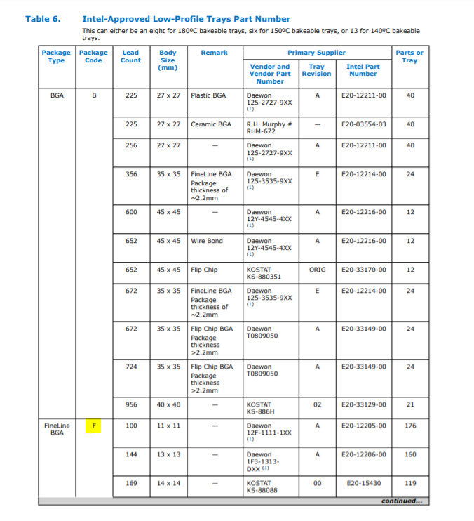

Yes. It should be the same. Here's a thread on how to find dimension: https://community.intel.com/t5/Programmable-Devices/MPN-10M16SCU324C8G-has-tape-and-Reel-packaging/m-p/1290640/emcs_t/S2h8ZW1haWx8dG9waWNfc3Vic2NyaXB0aW9ufEtRMEtYTFBFN0MzM0NUfDEyOTA2NDB8U1VCU0NSSVBUSU9OU3xoSw#M80306
In your case, it should be as below:

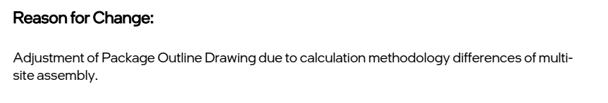

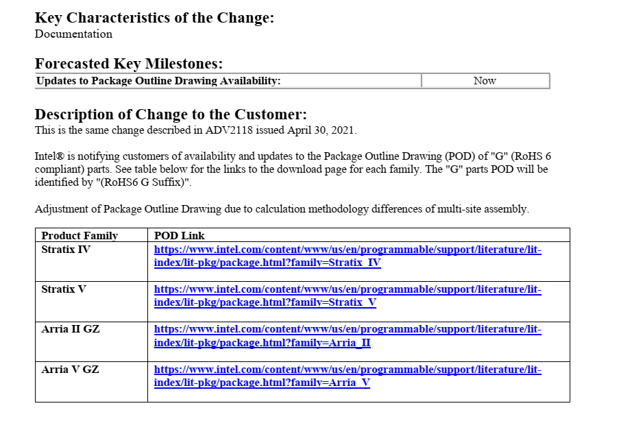

my questions related to PCN notification, mentioned POD drawing changed,
but when I checked my part in below link, POD drawing last revised in 2011, i did not noticed any changes
so I am confused with PCN notification what exactly changed in POD

There should not be any changes if the only changed notified is the additional 'G' prefix. That prefix only means RoHS6. You can refer to this KDB for more details: https://www.intel.com/content/altera-www/global/en_us/index/support/support-resources/knowledge-base/documentation/2019/rohs-compliant-ordering-part-number-for-arria-ii-and-stratix-iii.html

There should be no changes if that is the case.

I hope this is a document update only
