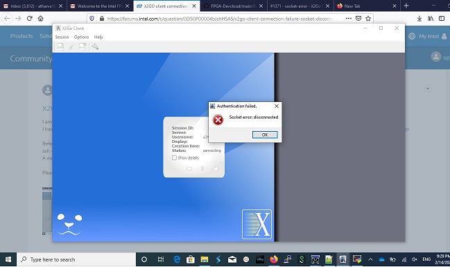

I am trying to open graphics port on DevCloud using X2GO clien and get socket disconnected error after starting the session
I have followed the steps from https://github.com/intel/FPGA-Devcloud/tree/master/main/Devcloud_Access_Instructions#61-opening-port-for-graphics-usage-in-x2go
Before launching the session I use the command
ssh -L 4002:s001-n<available node from 130-139>:22 devcloud
A minute after I launch the session, I get the error authentication failed-socket error :disconnected
Please find the attached images of the session properties and the error message.

    Can you show me the exact command you are using to open the port using the ssh command? First you need to open the port on your PC (not on the headnode) through Mobaxterm. For instance ssh -L 4002:s005-n006:22 colfax-intel
    opens the port on node graphics port for s005-n006. Please show the exact command you are running on the PC from Mobxaterm. Also note you first need to be logged into the compute node before executing this command. Cheers Larry

      Hi Larry,
      Apologies for the delay in my response. I was able to open graphics port and launch quartus on n137.
      What I missed earlier was logging in the the node before opening the port.
      In short this is what I did:
      ssh devcloud
      devcloud_login (select 137)
      ssh -L4002:s001-n137:22 devcloud
      Only at this point launch the X2GO session
      from the command prompt of GUI,
      tools_setup (select appropriate version)
      launch quartus using
      quartus &
      Thanks a lot for your help.
