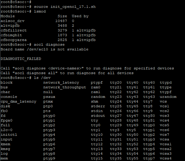

cross compile the aocl runtime driver with right kernel version and regenerate the aclsoc_drv.ko file. I run the init_opencl.sh file, including insmod aclsoc_drv.ko, it works well, I can find it by lsmod.
But when I execute "aocl program /dev/acl0 helloworld.aocx", it says:
Couldn't open /dev/acl0 device! Did you load the driver?
aocl program: Program failed.
And when I run "ls /dev", no acl0 listed there! How can I resolve this problem?

I am following the step 6 and 7 correctly, and we can find the module aclsoc_drv has been well installed.
Invoking the aocl diagnose utility command, the logs shows :
Board name /dev/acl0 is not available
DIAGNOSTIC_FAILED
Call "aocl diagnose <device-names>" to run diagnose for specified devices
Call "aocl diagnose all" to run diagnose for all devicesThen I run "ls /dev", no acl0 listed there. Theoretically, it should be added when we run "source init_opencl.sh", right?
