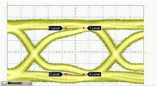

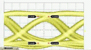

Below is a transmitter output eye diagram example captured on the 10G Base R PHY IP transmitter output for ACDS 11.0
The transmitter slew rate was set incorrectly in ACDS 11.0 and above. The figure below shows the improved eye diagram after applying the recommended workaround or software patch. This issue is targeted to be fixed in ACDS 11.1.
