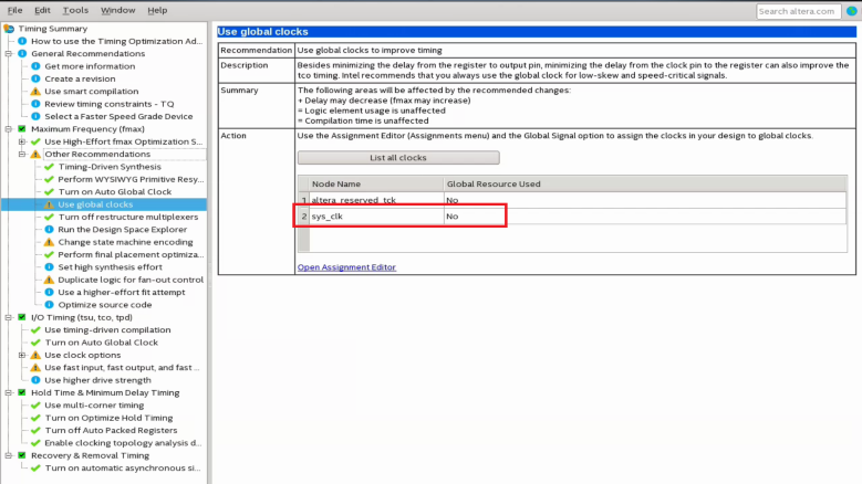

In Timing Optimization Advisor,

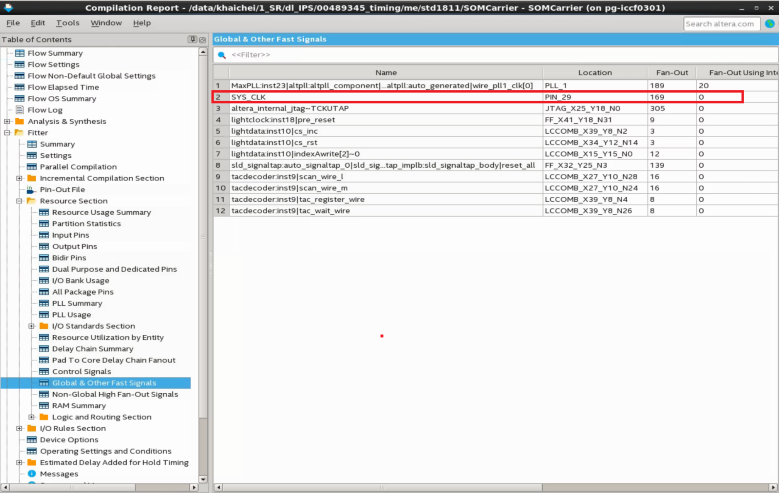

In Fitter report,

The Timing Optimization Advisor result is incorrect. You can follow the result in the Fitter report.
