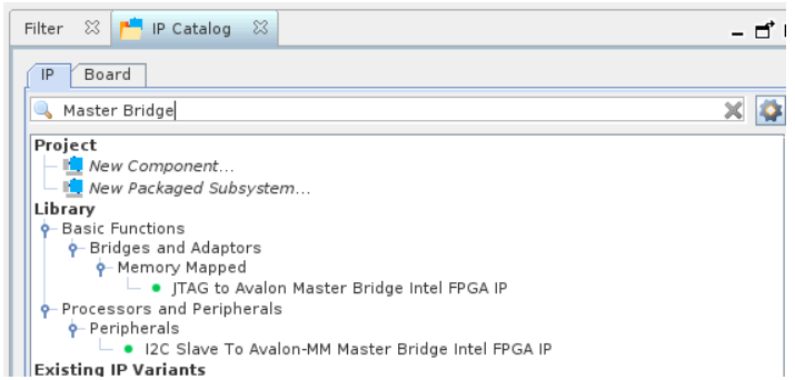

Why is the SPI slave to Avalon® Master Bridge IP missing from the IP Catalog for Agilex™ 5 FPGA devices in Quartus® Prime Pro Edition Software version 24.2
Description
Due to a problem in Quartus® Prime Pro Edition Software version 24.2, the SPI slave to Avalon® Master Bridge IP is missing from the IP Catalog for the Agilex™ 5 FPGA devices.
