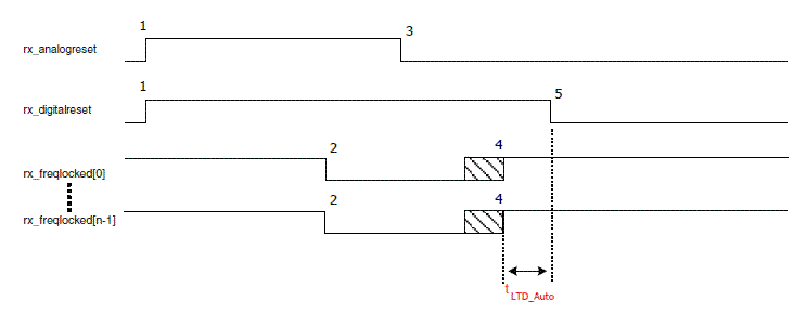

    As an alternative to the above software solutions, you can apply the reset sequence solution described below and illustrated in the waveforms in Figure 1 to resolve the problem.
    Figure 1. Reset Sequence Waveforms
    1. Assert the rx_analogreset and the rx_digitalreset signals.
    2. The rx_freqlocked[0..n-1] signals will go low, indicating that the transceivers are locking to the reference clock (lock to reference).
    3. Deassert the rx_analogreset signal. Ensure data is present at the receiver inputs before deasserting the rx_analogreset signal.
    4. The rx_freqlocked[0..n-1] signals will go high, indicating the transceivers are locking to data.
    5. About 4 µs (tLTD_Auto) after the last rx_freqlocked signal goes high, deassert the rx_digitalreset signal.
