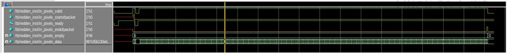

When you compile the HLS example xxx/hls/examples/tutorials/interfaces/explicit_streams_packets_empty with Intel® HLS Compiler version 19.2 and 20.1, you will get different waveforms. In version 19.2, the signal in_pixels_startofpacket has a start pulse, but in versions 19.3 and 20.1, the start pulse is missing.
19.2
20.1 and 19.3
