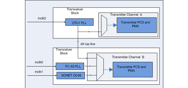

This issue is further explained with the following example: Consider a design with the following requirements
  • One channel (A shown in the figure) running at OTU1 data rate (2.666 Gbps)
  • One channel (B shown in the figure) capable of switching between OTU1, Fibre Channel 4G (4.25G), and SONET OC48 (2.488 Gbps)
  • Assume that the above two channels need to placed in two different transceiver blocks.
To implement this design, you must instantiate two ALTGX instances as shown below and use the Multi PLL reconfiguration feature (Option - "Use additional CMU/ATX PLL..." in the reconfiguration settings screen of the ALTGX Megawizard™)
  • ALTGX Instance 1: has Channel A, Main PLL as PLL2 running at 2666 Mbps.
  • ALTGX Instance 2: has Channel B, Main PLL as PLL0 (0 is the logical reference index of the PLL) running at 4250 Mbps, Additional PLLs as PLL1 running at 2488.32 Mbps and PLL2 running at 2666 Mbps
In both the ALTGX instances, keep the same number of input reference clocks. This is required to share PLL2 between the two instances as described in step3 below.
For this design configuration, only three PLLs are required to achieve this, as shown in Figure 1:
Figure 1.Multi PLL Reconfiguration Example Design Scenario

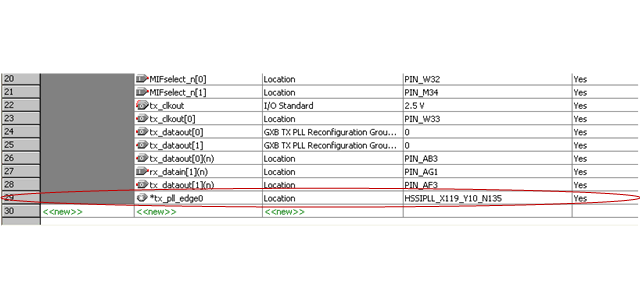

To merge the PLL2 of both the ALTGX instances into one physical transmitter PLL location,perform the following steps
1) Create a GXB TX PLL Reconfiguration group setting in the assignment editor and assign the same value (example: 0 or 1, 2,etc) for the tx_dataout of both instances
2) Manually assign location of the TX PLL that provides clocks to channels outside its transceiver block. In this example it is PLL2. The steps below show the manual location assignment method.
  • Select the GXB Transmitter PLL from the Resource Section of the Fitter option in the Compilation Report. You can see the transmitter PLL node information for all the PLLs used in the design.
  • For the PLL2, you can see two location assignments for the same node (example:tx_pll_edge0)
  • Use one of the two locations for tx_pll_edge0 and manually assign it in the assignment editor as shown in Figure 2
Figure 2.Manual Assignment of Transmitter PLL
View full size

3) Compile the design and observe the GXB Transmitter PLL from the Resource Section of the Fitter option in the Compilation Report
You can now see that the transmitter PLLs from the two instances have been merged into a single physical location ( example:HSSIPLL_X119_Y10_N135)
