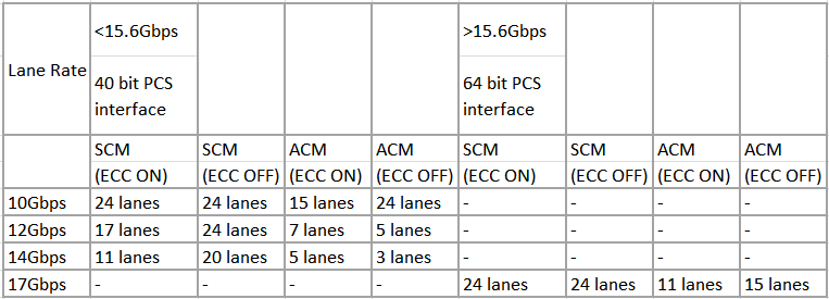

Not all variants of the SerialLite III Streaming IP core support maximum lanes. This is due to timing closure challenges. The following table lists the SerialLite III Streaming IP Core Arria 10 variants that can close timing at 10% margin. Other variants not listed in the table will face timing closure challenges.

Use high fitting effort for variants with more lanes. This issue will be fixed in a future release.
