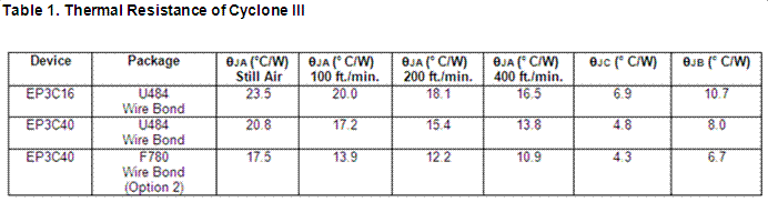

there is an update on thermal resistance value for EP3C16U484, EP3C40U484 and EP3C40F780 devices as Table below:

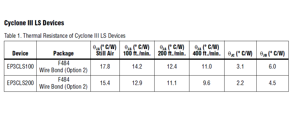

Be informed that there is an update on thermal resistance value for EP3CLS100 and EP3CLS200 as Table 1 below:

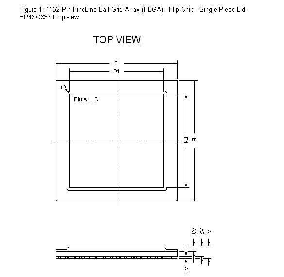

The package outline top view of 1152-Pin FineLine Ball-Grid Array (FBGA) - Flip Chip - Single-Piece Lid -EP4SGX360 is incorrect. The correct top view should be as Figure 1 (below).
The Altera Device Package Information data sheet (PDF) chapter will be updated to show the correct package outline for Stratix IV GX device (1152-Pin FineLine Ball-Grid Array (FBGA) - Flip Chip - Single-Piece Lid -   EP4SGX360).

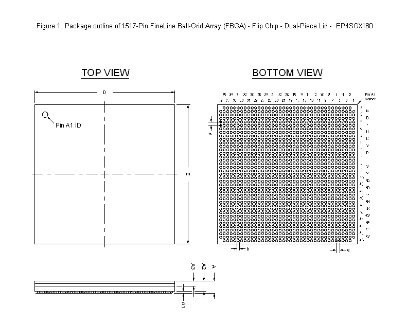

The package outline top view of 1517-Pin FineLine Ball-Grid Array (FBGA) - Flip Chip - Dual-Piece Lid -  EP4SGX180 is incorrect. The correct top view should be as Figure 1 (below).
