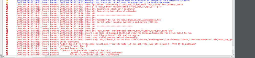

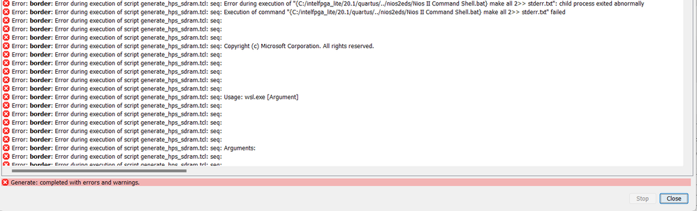

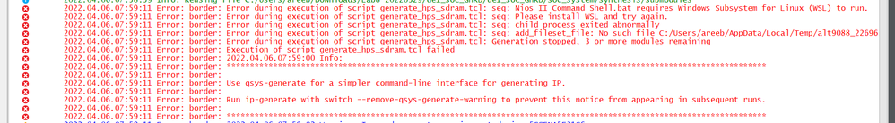

Unable to generate HDL GHRD DE1-Soc (Quartus prime 21.1)
Hi, I wish to generate HDL for GHRD for the DE1-Soc board.
However I get a bunch of error messages which I can't find much information online to fix.
Upgrading the IP works fine and I've done that, so no issues there.
Please have look at my screenshot, I would be great full if someone could help.
(The screenshot shows quartus 20.1 but I also have 21.1 installed. Someone told me 21.1 is not good and 20.1 is better for the DE1-Soc, anyway I have both installed and both give same error).

      Entire error script:
      Error: 2022.04.06.07:59:11 Error: border: Error during execution of script generate_hps_sdram.tcl: seq: Nios II Command Shell.bat requires Windows Subsystem for Linux (WSL) to run.
      Error: 2022.04.06.07:59:11 Error: border: Error during execution of script generate_hps_sdram.tcl: seq: Please install WSL and try again.
      Error: 2022.04.06.07:59:11 Error: border: Error during execution of script generate_hps_sdram.tcl: seq: child process exited abnormally
      Error: 2022.04.06.07:59:11 Error: border: Error during execution of script generate_hps_sdram.tcl: seq: add_fileset_file: No such file C:/Users/areeb/AppData/Local/Temp/alt9088_2269639312684602027.dir/0004_seq_gen
      Error: 2022.04.06.07:59:11 Error: border: Error during execution of script generate_hps_sdram.tcl: Generation stopped, 3 or more modules remaining
      Error: 2022.04.06.07:59:11 Error: border: Execution of script generate_hps_sdram.tcl failed
      Error: 2022.04.06.07:59:11 Error: border: 2022.04.06.07:59:00 Info:
      Error: 2022.04.06.07:59:11 Error: border: ********************************************************************************************************************
      Error: 2022.04.06.07:59:11 Error: border: Use qsys-generate for a simpler command-line interface for generating IP.
      Error: 2022.04.06.07:59:11 Error: border: Run ip-generate with switch --remove-qsys-generate-warning to prevent this notice from appearing in subsequent runs.
      Warning: 2022.04.06.07:59:11 Error: border: 2022.04.06.07:59:02 Warning: Ignored parameter assignment device=5CSEMA5F31C6
      Warning: 2022.04.06.07:59:11 Error: border: 2022.04.06.07:59:02 Warning: Ignored parameter assignment extended_family_support=true
      Warning: 2022.04.06.07:59:11 Error: border: 2022.04.06.07:59:05 Warning: hps_sdram: 'Quick' simulation modes are NOT timing accurate. Some simulation memory models may issue warnings or errors
      Warning: 2022.04.06.07:59:11 Error: border: 2022.04.06.07:59:05 Warning: hps_sdram.seq: This module has no ports or interfaces
      Warning: 2022.04.06.07:59:11 Error: border: 2022.04.06.07:59:05 Warning: hps_sdram.p0: p0.scc must be exported, or connected to a matching conduit.
      Warning: 2022.04.06.07:59:11 Error: border: 2022.04.06.07:59:05 Warning: hps_sdram.as: as.afi_init_cal_req must be exported, or connected to a matching conduit.
      Warning: 2022.04.06.07:59:11 Error: border: 2022.04.06.07:59:05 Warning: hps_sdram.as: as.tracking must be exported, or connected to a matching conduit.
      Warning: 2022.04.06.07:59:11 Error: border: 2022.04.06.07:59:05 Warning: hps_sdram.c0: c0.status must be exported, or connected to a matching conduit.
      Warning: 2022.04.06.07:59:11 Error: border: 2022.04.06.07:59:05 Warning: hps_sdram.p0: p0.avl must be connected to an Avalon-MM master
      Error: 2022.04.06.07:59:11 Error: border: 2022.04.06.07:59:05 Info: hps_sdram: Generating altera_mem_if_hps_emif "hps_sdram" for QUARTUS_SYNTH
      Error: 2022.04.06.07:59:11 Error: border: 2022.04.06.07:59:07 Info: pll: "hps_sdram" instantiated altera_mem_if_hps_pll "pll"
      Error: 2022.04.06.07:59:11 Error: border: 2022.04.06.07:59:07 Info: p0: Generating clock pair generator
      Error: 2022.04.06.07:59:11 Error: border: 2022.04.06.07:59:07 Info: p0: Generating hps_sdram_p0_altdqdqs
      Error: 2022.04.06.07:59:11 Error: border: 2022.04.06.07:59:10 Info: p0:
      Error: 2022.04.06.07:59:11 Error: border: 2022.04.06.07:59:10 Info: p0: *****************************
      Error: 2022.04.06.07:59:11 Error: border: 2022.04.06.07:59:10 Info: p0: Remember to run the hps_sdram_p0_pin_assignments.tcl
      Error: 2022.04.06.07:59:11 Error: border: 2022.04.06.07:59:10 Info: p0: script after running Synthesis and before Fitting.
      Error: 2022.04.06.07:59:11 Error: border: 2022.04.06.07:59:10 Info: p0: "hps_sdram" instantiated altera_mem_if_ddr3_hard_phy_core "p0"
      Error: 2022.04.06.07:59:11 Error: border: 2022.04.06.07:59:11 Error: seq: Nios II Command Shell.bat requires Windows Subsystem for Linux (WSL) to run.
      Error: 2022.04.06.07:59:11 Error: border: 2022.04.06.07:59:11 Error: seq: Please install WSL and try again.
      Error: 2022.04.06.07:59:11 Error: border: 2022.04.06.07:59:11 Error: seq: child process exited abnormally
      Error: 2022.04.06.07:59:11 Error: border: 2022.04.06.07:59:11 Error: seq: add_fileset_file: No such file C:/Users/areeb/AppData/Local/Temp/alt9088_2269639312684602027.dir/0004_seq_gen
      Error: 2022.04.06.07:59:11 Error: border: while executing
      Error: 2022.04.06.07:59:11 Error: border: "add_fileset_file $file_name [::alt_mem_if::util::hwtcl_utils::get_file_type $file_name 0] PATH $file_pathname"
      Error: 2022.04.06.07:59:11 Error: border: ("foreach" body line 4)
      Error: 2022.04.06.07:59:11 Error: border: invoked from within
      Error: 2022.04.06.07:59:11 Error: border: "foreach file_pathname $return_files_sw {
      Error: 2022.04.06.07:59:11 Error: border: _dprint 1 "Preparing to add $file_pathname"
      Error: 2022.04.06.07:59:11 Error: border: set file_name [file tail $file_pathname]
      Error: 2022.04.06.07:59:11 Error: border: add_fileset_file $..."
      Error: 2022.04.06.07:59:11 Error: border: (procedure "generate_sw" line 18)
      Error: 2022.04.06.07:59:11 Error: border: "generate_sw $name $fileset"
      Error: 2022.04.06.07:59:11 Error: border: ("if" then script line 4)
      Error: 2022.04.06.07:59:11 Error: border: "if {[string compare -nocase $fileset QUARTUS_SYNTH] == 0} {
      Error: 2022.04.06.07:59:11 Error: border: set top_level_file "altera_mem_if_hhp_qseq_synth_top.v"
      Error: 2022.04.06.07:59:11 Error: border: add_fileset_file $top_level_fi..."
      Error: 2022.04.06.07:59:11 Error: border: (procedure "generate_files" line 4)
      Error: 2022.04.06.07:59:11 Error: border: "generate_files $name QUARTUS_SYNTH"
      Error: 2022.04.06.07:59:11 Error: border: (procedure "generate_synth" line 3)
      Error: 2022.04.06.07:59:11 Error: border: "generate_synth altera_mem_if_hhp_qseq_synth_top"
      Error: 2022.04.06.07:59:11 Error: border: 2022.04.06.07:59:11 Info: seq: "hps_sdram" instantiated altera_mem_if_hhp_ddr3_qseq "seq"
      Error: 2022.04.06.07:59:11 Error: border: 2022.04.06.07:59:11 Error: Generation stopped, 3 or more modules remaining
      Error: 2022.04.06.07:59:11 Error: border: 2022.04.06.07:59:11 Info: hps_sdram: Done "hps_sdram" with 7 modules, 33 files
      Info: 2022.04.06.07:59:11 Info: border: "hps_io" instantiated altera_interface_generator "border"
      Error: 2022.04.06.07:59:11 Error: Generation stopped, 2 or more modules remaining
      Info: 2022.04.06.07:59:11 Info: soc_system: Done "soc_system" with 63 modules, 119 files
      Error: 2022.04.06.07:59:12 Error: qsys-generate failed with exit code 1: 70 Errors, 10 Warnings
