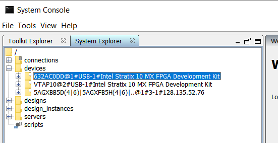

The device list in the system console shows up as 632AC0DD.
When I try to link with a project built based on the device part number, I am prompted with the error below,
Raam

The issue was with the clock_controller application that sets the default clocks. Once that is straightened, device was recognized correctly by the JTAG chain.
