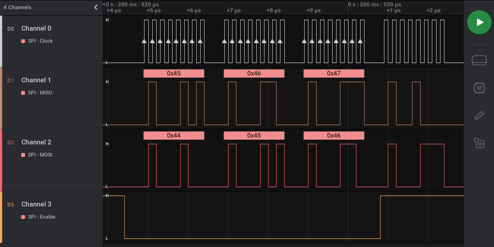

Do you know if is possible to extend Signaltap with custom protocol analyzers (ex. I2C, SPI, etc..)?

    Signal Tap just taps signals. It's not designed for that. A better option is using System Console toolkits. What exactly do you want to see?

      I would like to create a plugin or something that decode the data on some protocols, for example:

    You can create mneumonic tables in Signal Tap, but those are meant to decode "parallel" signals (i.e. the seven separate signals that make up a 7-segment display) as opposed to decoding serialized data like what you show here. Signal Tap can't do that. It only looks at captured data one clock cycle/sample at a time.
