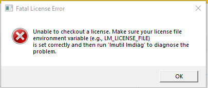

Questa Intel FPGA starter unable to checkout a license

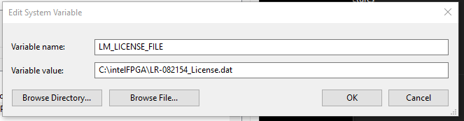

hi, i keep getting "Fatal License Error" when launching Questa FPGA starter. I have done the System Environment setup for LM_LICENSE_FILE, but still not able to detect my license. Any workaround I can try?

    The website generating licenses is often broken, I suggest you to contact Intel support

    There are issue with Questa license generated recently.
    I believe that the issue has been resolved.
    Could you help to apply again Questa license in Self Service Licensing Center https://licensing.intel.com/ ?
