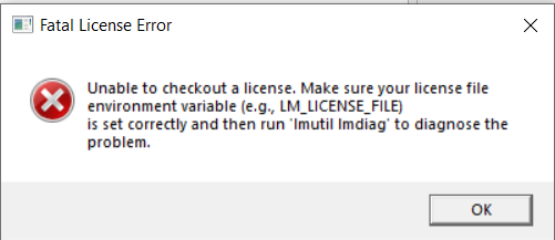

    • Val3's avatar
      Val3
      Thank you for the help.
      I generated and received new license for "Questasim*-Intel® FPGA Starter Edition".

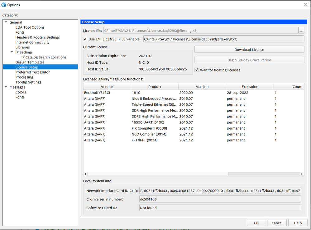

      1. Quartus is now pointed to this file location with added my floating license port@server after ";" at the same line.
      2. I modified LM_LICENSE_FILE variable to have full path to the file with new Questa license and added my floating license port@server after ";".
      Questa can't find license as before. Quartus works fine.
      Please advise how to resolve that issue.
      Val

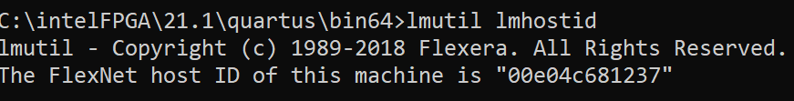

    • Val3's avatar
      Val3
      Answering your questions:
      1) Debug/error.log file
      I can't locate any debug/error.log file associated with this issue

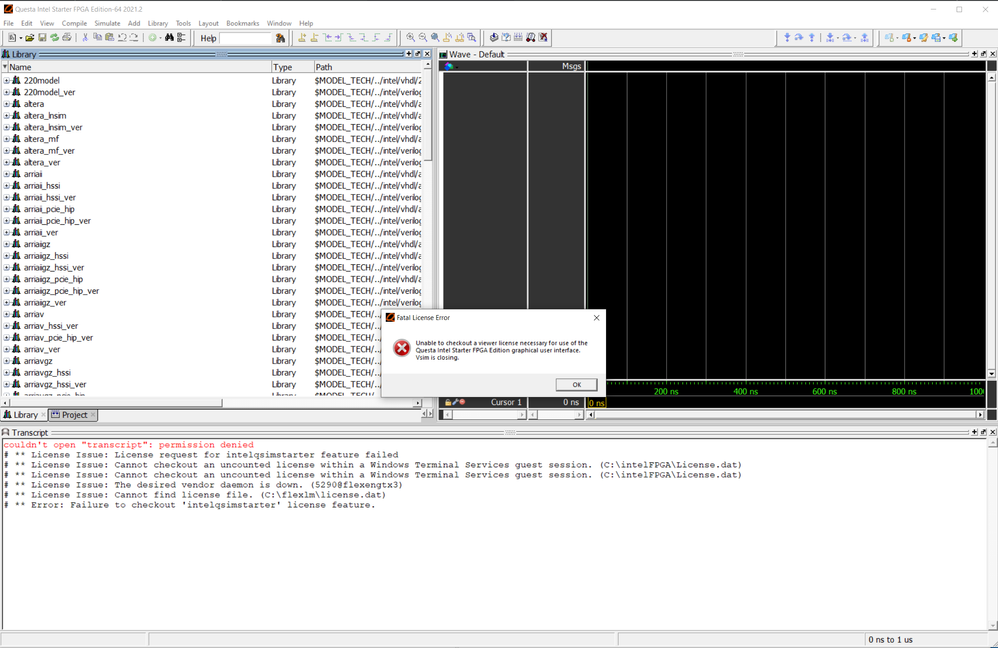

      2) Error message screen shot
      3) Screenshot of Quartus II>>tools>>license setup

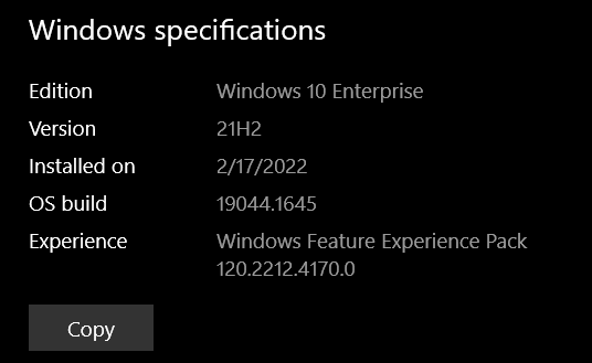

      4) Machine OS information

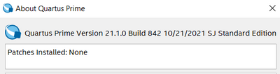

      5) Quartus version used
      6) Output of “lmutil lmstat –a –c <port>@<address>” server and client
      Attached: lmstat.txt
      7) License.dat file (Questa)
      Attached: License.zip
      I can't see the option there to send private message.
      Val

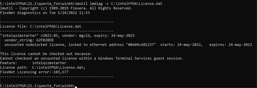

      I can see some progress with the license file generated today. At least now Questa opens main window. But some features can't be found in this license file:
      Attached please find updated license file.
      Looks like the main reason for the issue is my work with this PC via RDP (Remote Desktop) session.
