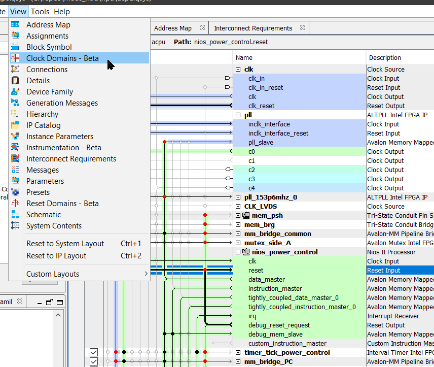

Platform Designer clock domain colors won't turn off
Anyone know how to turn off the colors? I tried "Clock Domains - Beta" and now I can't get the colors to go away.

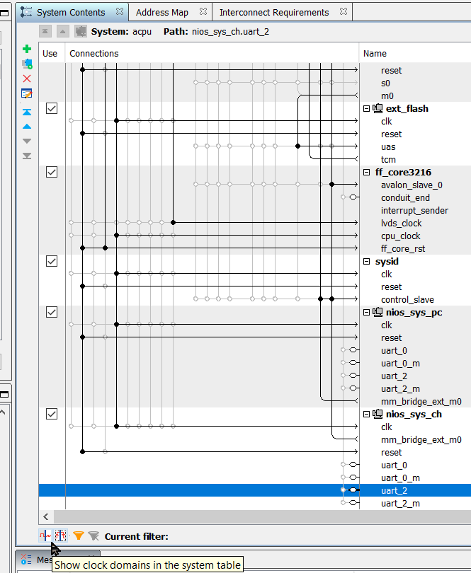

  • Click the clock domain filtering button at the bottom of the System Contents (or System View) tab. It's the far left button.
  • qwk000's avatar
    qwk000
    That is hidden really well. Thank you sir!
