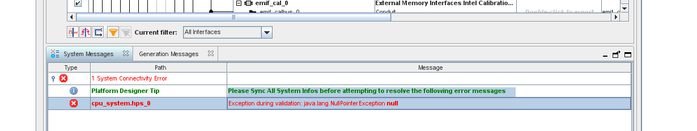

I then opened the QSYS file directly into Platform Designer, and I seem to get this error.

Are you saying that "Sync System Infos" (button at the bottom of PD) is what just keeps spinning?

It was the auto-update IP in the main Quartus tool that kept spinning. The "Sync System Infos" completes "successfully" (green) but displays the error message I showed above.

Since the error involves the HPS, have you tried removing it from the system and then re-adding it from scratch?
