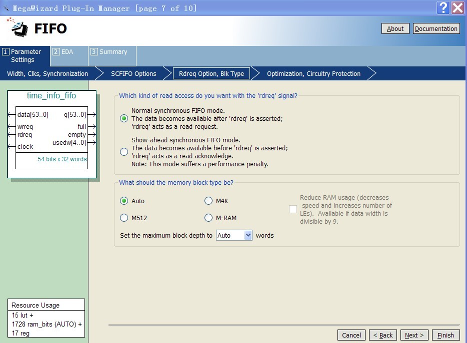

I'm using ArriaGX FPGA devices and there are many small fifo blocks will be used in my project. So i want to implement these samll fifo using LE and save RAM. I remenber that i can enable this option in older version QII, but can't enable this option in 11.0 version as attached image file shown now.
There is a option in 11.0, but it's gray and not be used for user.

    Altera_Forum
