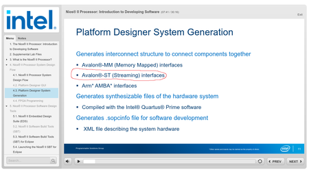

In one of the webinars, i was told that i can configure the Nios 2 with an Avalon ST interface.
But when i configure the Nios 2 softcore in the Platform Designer, i cant see an option...
sstrell
4 years agoThe training is saying that PD supports streaming interfaces. Not all IP support streaming, though. Nios uses memory-mapped interfaces. You can add components to essentially convert between the two standards, like a FIFO, where you can have memory-mapped on one side and streaming on the other.
