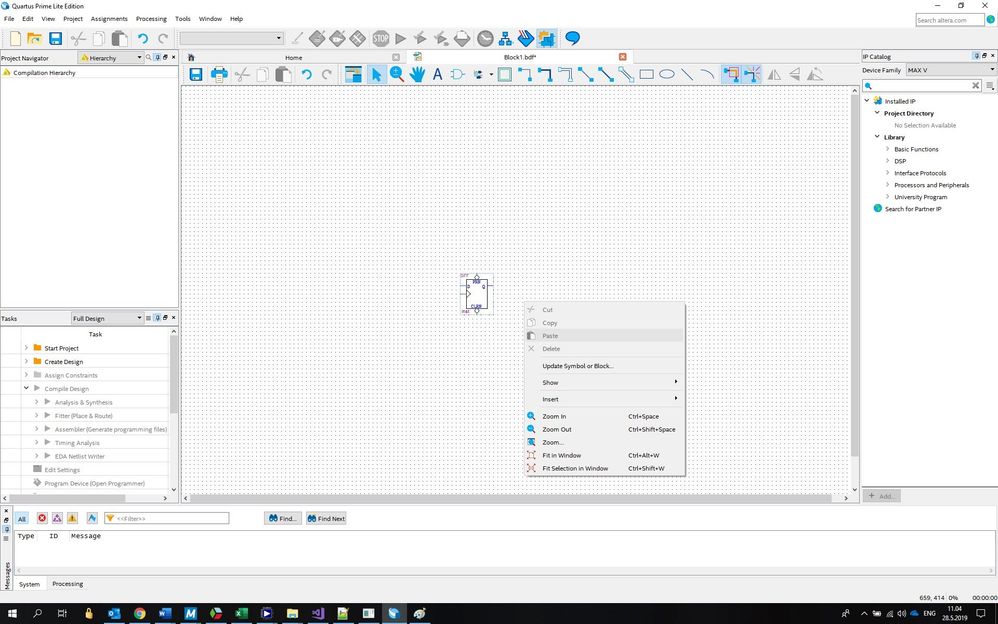

    Thanks for your quick reply. I have the issue with Quartus Prime Version 17.0.0 for example. When I open a block diagram/schematic file and I right click copy a DFF symbol for example, when i want to paste it somewhere else into my block diagram/schematic file, right click Paste is in grey color.

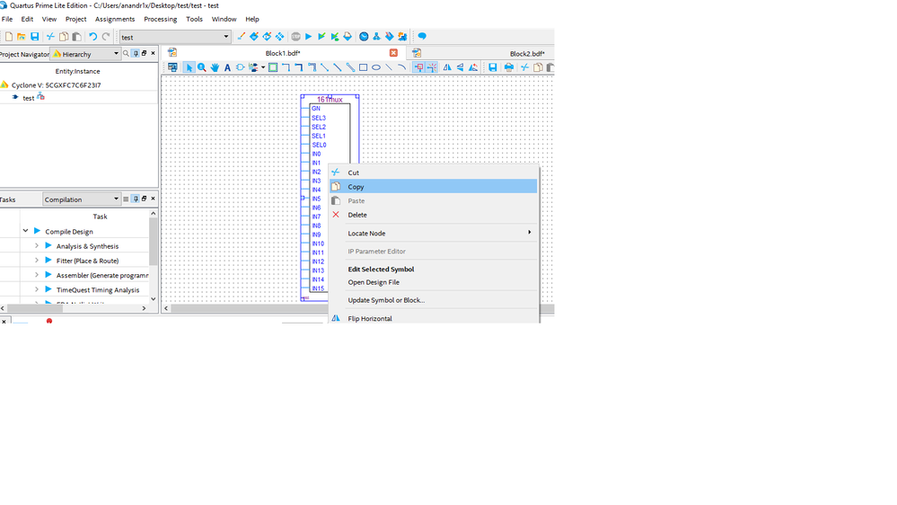

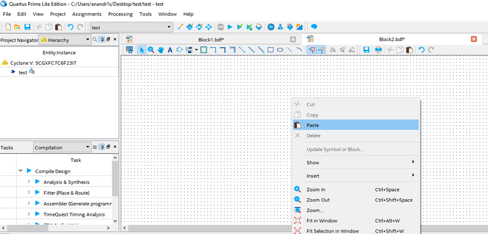

    • AnandRaj_S_Intel's avatar
      AnandRaj_S_Intel
      Hi Fabric,
      I have checked it in Quartus std 17.0 it is working fine.
      Are using Lite/Std/Pro?
      Please do share image with diagram/schematic file right click Paste is in grey color.

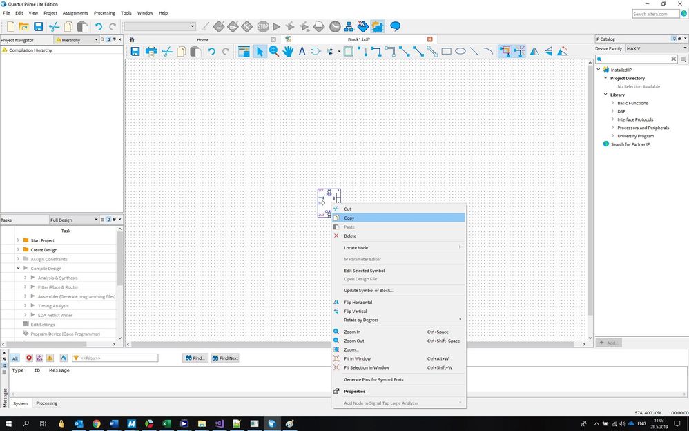

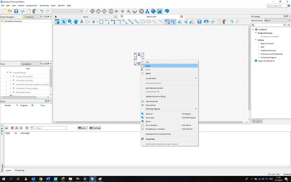

  • Fabe64's avatar
    Fabe64
    Hi Anand,
    Please, find below the images that I just took from Quartus. Feel free to ask me if you need more information.
    Fabrice

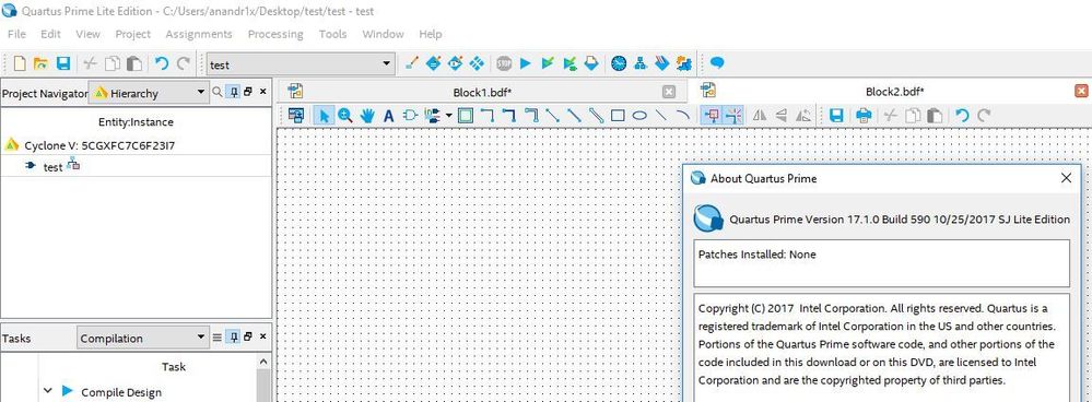

    AnandRaj_S_Intel
    ​Hi,
    We have tried to replicate the scenario on Quartus 17.0 lite. However it worked fine on Quartus 17.0 & 17.1 LITE.
    1. try by reinstalling Quartus 17.0 lite
    2. Or use latest Quartus lite version.

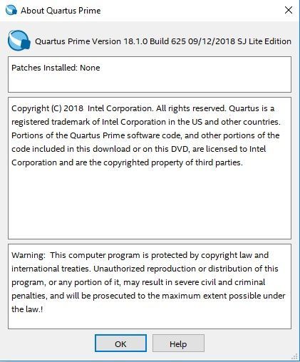

  • Fabe64's avatar
    Fabe64
    Hi Anand,

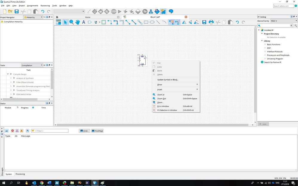

    I have also installed in same computer Quartus 18.1 Lite. And it seems that it does the same thing. I have a colleague which has Quartus 17.0 lite and this copy/paste functionality works.
    Please, check the print screens which I just did.
    Thank you in advance for your comments.
    Fabrice

      ​Hi Fabrice,
      Copy past operation Works fine in Quartus.
      May be problem with Quartus Installation or environments (OS).
      Try to install it in new pc.
