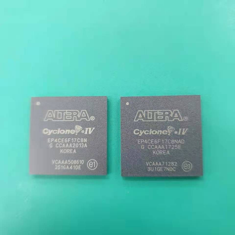

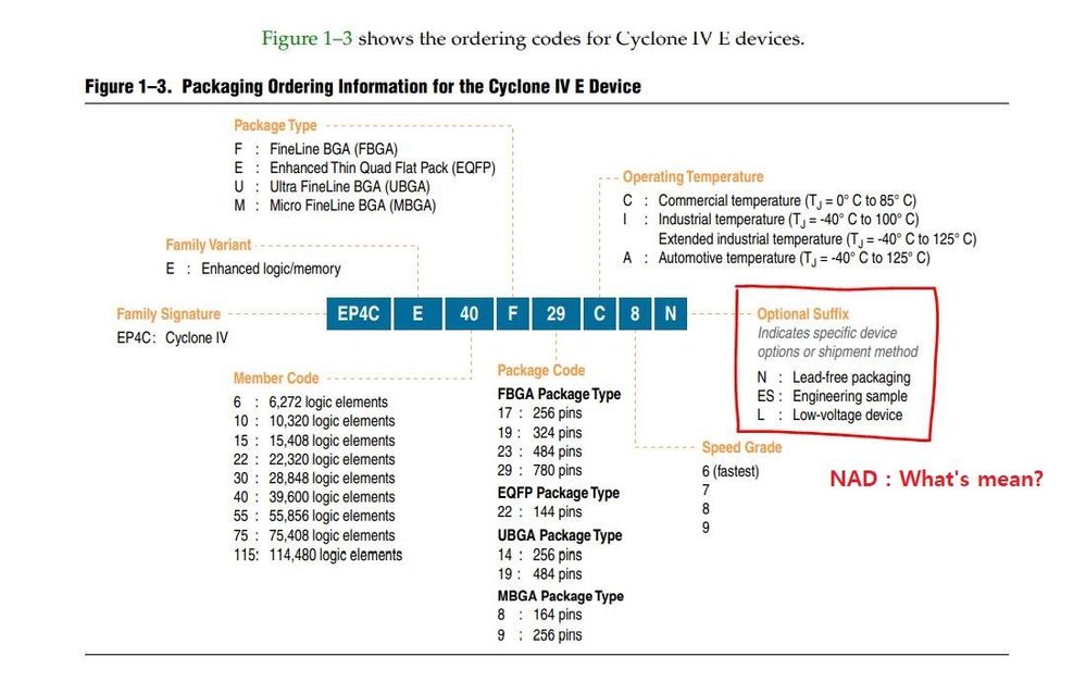

What does NAD mean in EP4CE6F17C8NAD ?
Thank you for the reply.
I understand both part is same. but this product is still not working
So I would like to know what this optional suffix means?
because I have to explain to my boss that the two products are the same
Thank you
1 Reply
  • JohnT_Altera's avatar
    JohnT_Altera
    The additional suffix is a special requested part with some special condition. It is actually the same part as the part with the 'AD' suffix. May I know how do you get the part with "AD" suffix and who do you order the part from?
