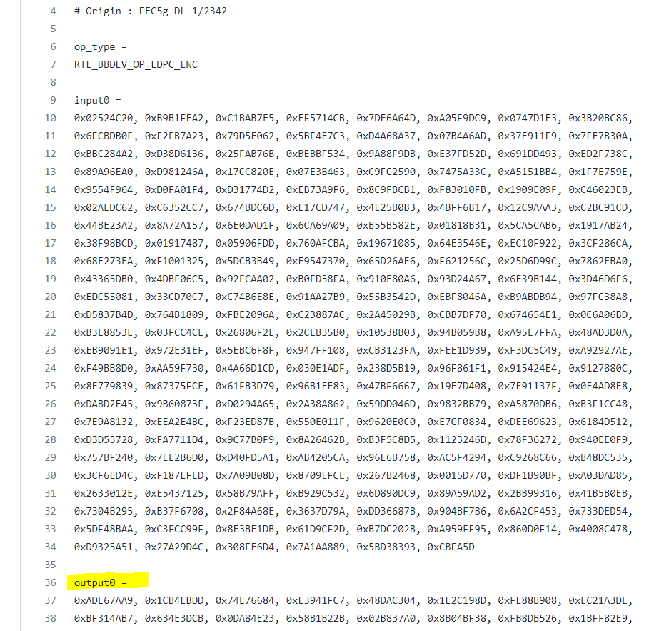

we are trying to enable LDPC FEC accleration in Flexran server using PAC3000 card. We were able to run the l1app with Fec accelaration and the testmac testcases are passing. We are also able to run the test-bbdev application. Now we want to bring out the encoded data from the PAC through the Ethernet interface and take it to an external viewer. Is there any method enable this..?

    You can modify the test_bbdev_perf.c...add printf to print the output.
  • JonWay_altera's avatar
    JonWay_altera
    Testbbdev compares the hardware output vs the reference output in the test_vector.
    If you want to know the expected output, you can refer to the test_vector's output.

    Hi there, the LDPC acceleration is a lookaside acceleration via PCIe (not the ethernet).
    The encoded data are streamed back to the host memory via PCIe. As it is processed realtime, it wont be fast enough to print the results. If you are looking to run a sanity test. I would suggest that you perform the DPDK bbdevtest : https://doc.dpdk.org/guides/tools/testbbdev.html
