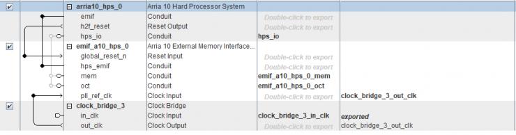

In the platform designer I made the following connection:Since I didn't connect the differential clock outside BANK 2K, I added the clock_bridge ip. I connected the out_clk of the clock bridge to the pll_ref_clk. There was no error in the platform designer.

Error(14566): The Fitter cannot place 1 periphery component(s) due to conflicts with existing constraints (1 REFCLK_GROUP(s)). Fix the errors described in the submessages, and then rerun the Fitter. The Intel FPGA Knowledge Database may also contain articles with information on how to resolve this periphery placement failure. Review the errors and then visit the Knowledge Database at https://www.altera.com/support/support-resources/knowledge-base/search.html and search for this specific error message number. Error(175020): The Fitter cannot place logic REFCLK_GROUP that is part of Generic Component ARRIA10_emif_a10_hps_0 in region (38, 5) to (38, 98), to which it is constrained, because there are no valid locations in the region for logic of this type.
In this case, what suggestions can be set to generate pll_ref_clk clock, so as to achieve the DDR3 read and write control.
