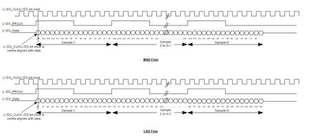

Hello there, I have a Texas Instruments module that outputs ADC data using 4-lanes LVDS from its Mezzanine connector. It provides LVDS_CLK and LVDS Frame Clock alongwith. I want to receive this dat...
