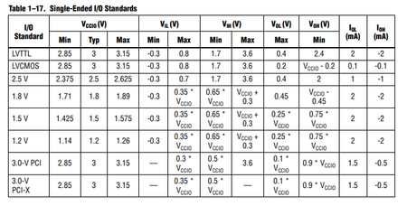

Hi We have an existing board containing a EP4SE360F35I3 (F1152 PACKAGE). I am trying to determine the maximum input Voltage that can be safely be fed into a dedicated clock input pin (single ended)....

Good morning and thank you for getting back to me.
The table was taken from the following document…
https://www.intel.com/content/dam/www/programmable/us/en/pdfs/literature/hb/stratix-iv/stx4_siv54001.pdf
Table 1-17 (Single-Ended I/O Standards) on page 1-12.
