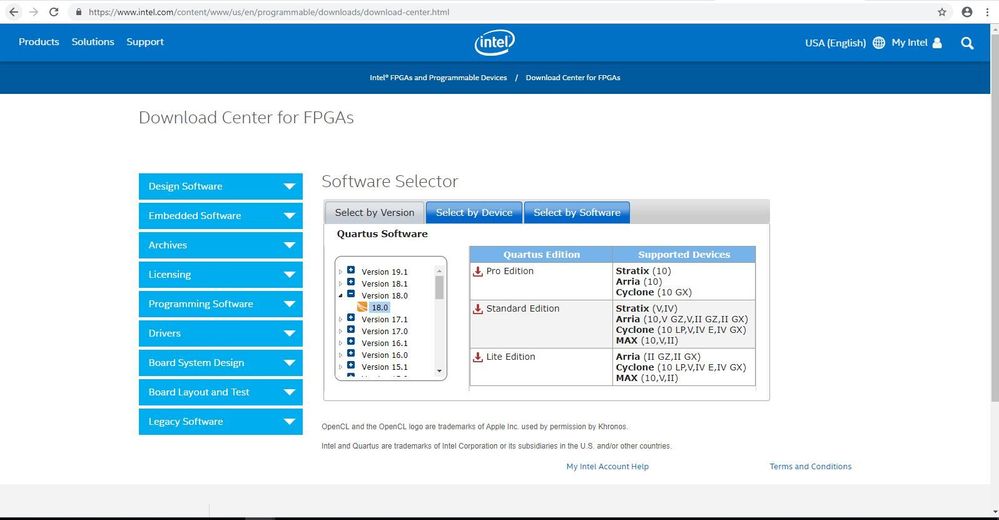

install devices in quartus 18
like to add cyclone IV family of devices

    In addition, you can use Cyclone IV family devices with Quartus version 18 of either lite or standard edition.
    If it is not installed in Q18 then download the .qdz file for cyclone IV devices(Individual Files from link below) & install it using Device Installer (Quartus 18) from windows.
    http://fpgasoftware.intel.com/18.0/?edition=lite
