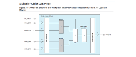

The picture below is used to clarify some point of the step-by-step approach here above.
The highlighted dark blue lines depict the LL region which consists of the 7 DSP blocks (which I gave a light blue color). In the Logic Lock properties you see the design elements that I added and also the excluded element types which gives the fitter more freedom.If we now look into the Technology map viewer we see that the fitter successfully uses the two multipliers from each DSP block and also bypasses the adder.
