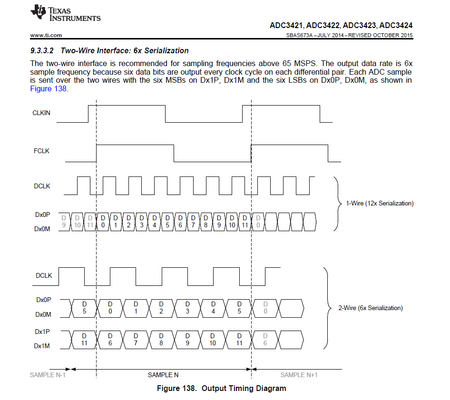

5 years agohow to achieve 4 channel LVDS ADC read
ADC: TI ADC3422 , 4 channel 12 bit ADC with 50M sample rate, LVDS
FPGA: Intel EP4CE15M9I7N
To read this ADC, so the clock should be as fast as 150MHz at rising and falling edge.
Is t...

In adc spec, there is frame clock output, but I am not sure which signal in IP ALTLVDS_RX could match it?
