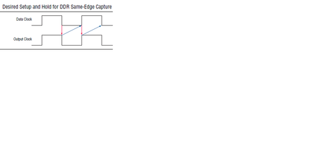

6 years agoFPGA-centric means it's contained within the device itself. As such, the hold analysis happens at the same edge at the boundary of the FPGA as opposed to 1 cycle earlier which is where it would be for the "downstream" device. I would stick with the system-centric approach. It's easier to understand and implement. You can see a good explanation of AN433 in the associated online trainings:
https://www.intel.com/content/www/us/en/programmable/support/training/course/ocss1000.html
https://www.intel.com/content/www/us/en/programmable/support/training/course/oddr1000.html
