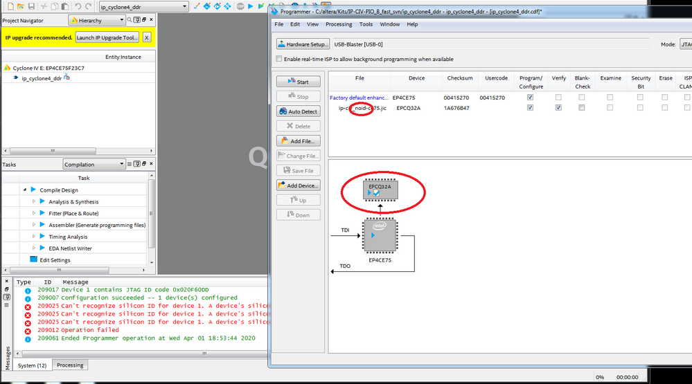

EP4CE75 -- EPCQ32A will not program. "Device 1 has wrong silicon ID" (This ID IS 16).
I'm using Quartus 15 thru 19.

- In the picture above, are you using Quartus 15 or 19? What do you mean by using Quartus 15 thru 19?
- If you are using Quartus 19, you need to fully recompile your design again as you are using IP config in the design.

Hi AMazb,
Please be noted that EPCQ-A device only support Quarus 17.1 and above.
Please refer to below link for further information:
https://www.intel.com/content/dam/www/programmable/us/en/pdfs/literature/an/an822.pdf

- AMazb
This is Quartus 19 with a "A" device and a working board.
Per my original question. "I'm using Quartus 15 thru 19".
