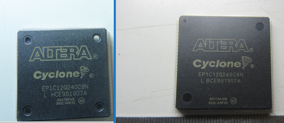

EP1C12Q240C8N I have got the parts on hand are different lead frame, please help to confirm is it possible?
in attached file ,
left side coo:PH
right side coo:MY
their D/C are 1907

    OPN EP1C12Q240C8N both Assembly site ASEM and ATP are qualified for this package/device type. Probably your company received the part from ATP and now received ASEM part (qualified and assembled since 2003) which brought your attention due to different in lead frame design. However, please note that the different of design does not impacted the functionality of the device/package.
    Hope this clarify and apologize for the inconveniences.

    jchiu23
    Hi Aim,
    here is the pic of the top marking .
    thanks.
  • Hi,
    Can you provide us the Top picture of the devices as we need to consult this with our packaging team.
    Thank you.
    Aim
