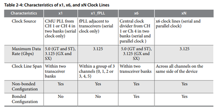

5 months agoCyclone V SoC 5CSXC6 Series GXB Utilization and Limitations
Dear Intel Altera, I would like to confirm that the 6 channels GXB device: Q1) Do it possible to use all 6 TX / RX GXB Transceivers when Hard PCIe is used. Based on: CV-53004 There are no specifi...

Hi Brian,
Thank you for the update.
Just to clarify, the legacy database I referred to is our internal database for legacy devices. Unfortunately, there is limited information available regarding this wrong data issue. Based on the available info, I believe it was originally initiated from a customer-reported case.
You are also correct that the placement rules are enforced within Quartus. Since these rules are built into the tool, they cannot be overridden through a TCL command.
