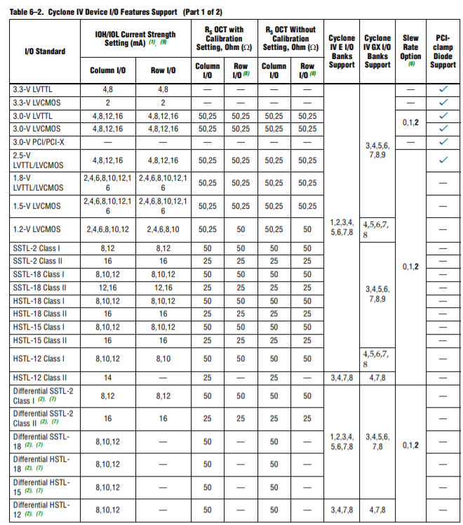

[Binayak]: I have seen the I/O tables. The 3.3V LVCMOS only has drive strength of 2mA. Really don't know how you can drive 50 ohms transmission lines such low drive strength.

Hello Binayak,
The output buffer for each Cyclone IV I/O pin has a programmable current strength
control for certain I/O standards. The supported settings ensure that the device driver
meets the specifications for IOH and IOL of the corresponding I/O standard to decrease the effects of simultaneously switching outputs (SSO) in conjunction with reducing system noise.When you use programmable current strength, on-chip series termination (RS OCT) is
not availableThe default current strength setting in the Quartus II software is 50-ohm OCT without calibration for all non-voltage reference and HSTL/SSTL Class I I/O standards. The default setting is 25-ohm OCT without calibration for HSTL/SSTL Class II I/O standards.
This table might be helpful for you
Thank you.
