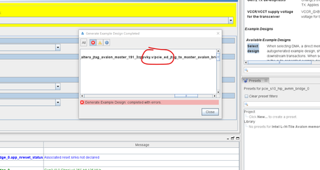

3 years agoCannot generate pcie avmm example design
Using Quartus Prime Pro 22.3. During the file generation process, it first creates the example design in the temporary folder on the C drive. However, in the final step, I encounter an issue where a ...

Hi Allen,
that is limitation of Window OS,
As previous reply, you can try to generate the example design in Linux OS and use it in Windows OS.Let me know if there is anything else I can help you.

Can you please provide me the device OPN ? I will try to replicate this on my place and see if I can see the same error as yours or not.

3 years agoI use stratix 10 - 1SX110HN2F43I2VG
