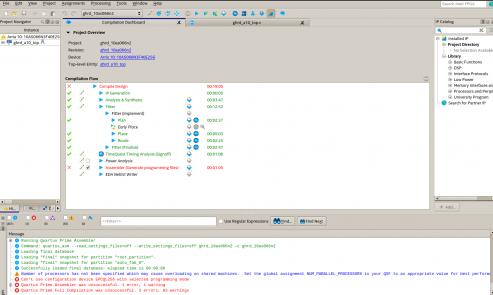

I have an Arria 10 SoC board , and i'm using quartus prime pro edition v 17.0,
the problem is when i try to synthesis the GHRD , quartus pro shows this error (see attachment ),
can anyone help me please.
Thank you ,
ifarhat
errors :
Error: Peak virtual memory: 6654 megabytesError: Processing ended
Can't use configuration device EPCQL256 with selected programming modeError:
Quartus Prime Assembler was unsuccessful. 1 error, 1 warningError: Peak virtual memory: 6654 megabytesError:
Processing ended: Thu Apr 5 16:42:45 2018Error:
Elapsed time: 00:01:02Error:
Total CPU time (on all processors): 00:01:16Error(293001):
Quartus Prime Full Compilation was unsuccessful. 3 errors, 83 warnings

    I have found the issue,
    after unchecking the "early release HPS ... " in Assignment->device->device and pin options , open up the ghrd_xxxx.qsf and comment this line “set_global_assignment -name USE_CONFIGURATION_DEVICE ON”.
