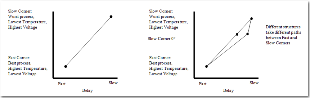

I am confused about the fast and slow corners on pg 123 in the Timequest guide on the Altera Wiki. I am not able to see how fast corner can be at high temp and low voltage and vice-versa.

Check on this explanation https://www.intel.com/content/dam/www/programmable/us/en/pdfs/literature/wp/wp-01139-timing-model.pdf, pg4. Fast corner should be in condition of high voltage and low temp.
