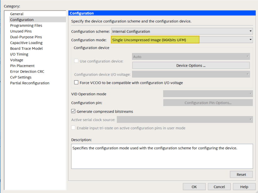

The following error can be found after compilation.
"current internal configuration mode does not support memory initialization or rom. select internal configuration mode with eram"
I use Quartus Prime 18.1 Lite edition ,10M02SCU169A7G, the same error would not happen if switching to Cyclone IV or other device.
Please let me know how to fix this error.
Any help would be appreciated.
- Vicky1
Hi Jamie, Please try to check with below option, Assignments -> Device -> Device and Pin Options -> Configuration -> Configuration Mode: Single uncompressed image with Memory Initialization Refer the below old thread, https://forums.intel.com/s/question/0D50P00003yyRGESA2/max10-select-internal-configuration-mode-with-eram-?language=en_US let me know if this has resolved your issue. Regards, Vikas- JW1121
Hi Vikas,
I had tried it before, the problem still exists during compilation.
Jamie
- Vicky1
Hi Jamie, Apologies for the late response,if you refer the Table 2. & Table 3. of Intel MAX10 user flash memory user guide, here 'Single compressed/uncompressed image with memory initialization" is not available for MAX10(SC/DC) compact variant so I would suggest, if possible use MAX10(SA/DA) device. https://www.intel.com/content/dam/www/programmable/us/en/pdfs/literature/hb/max-10/ug_m10_ufm.pdf https://www.intel.com/content/www/us/en/programmable/documentation/myt1396938463674.html#myt1396949701969 Please let me know if you have any concern. Regards, Vikas- JW1121
