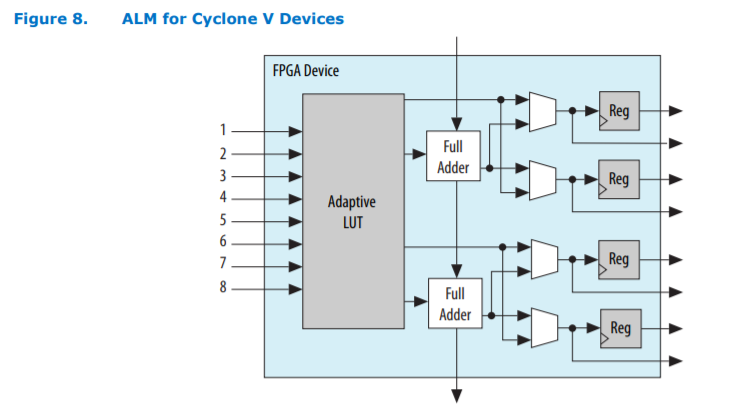

Cyclone V devices use a 28 nm ALM as the basic building block of the logic fabric. The ALM has an 8-input fracturable look-up table (LUT) with four dedicated registers.
(Source: https://www.intel.com/content/dam/www/programmable/us/en/pdfs/literature/hb/cyclone-v/cv_51001.pdf)
