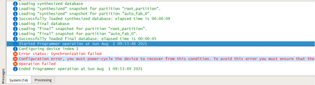

I tried to program .sof file into Intel S10mx development kit,but failed.
I reboot the PC several times and I try different PC, the errors came up the same .
Error(18952): Error status...

I did program the fpga after power up.
The link you mentioned above provide the solution for S10 SX/GX, not for S10mx. And I have tried the Patch 0.13 Link, and it didn't work.
