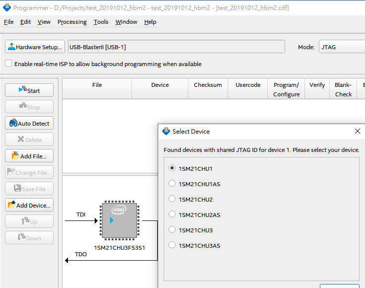

We used Quartus v19.3,
and Programmer could detect the device as the following figure.
We are not sure which one is correct.

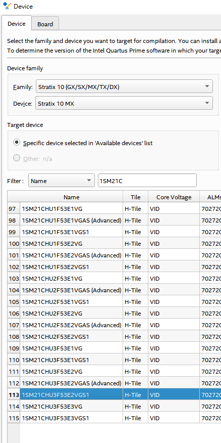

Besides, when we opened a new project, the device list we could choose is shown as following figure.
It's a bit different from the above detected name.
And we also don't know which one we should choose.

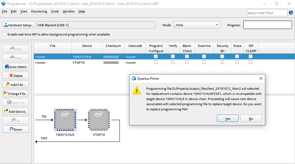

We tried and got a warning message as follows.
And then the programming process failed.
